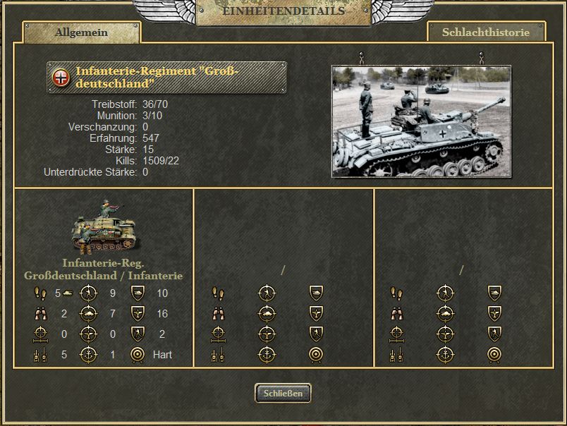

    Hello nono hard et heavy,
    Infanterie Regiment Grossdeutschland.jpg (109.88 KiB) 8679-mal betrachtet
    this unit need no transportation, it moves five fields on his tank tracks. I spent him an one point moving hero.
    - Götterdämmerung is an single campain like the other three campains HGN - HGM - HGS.
    - I think you have to buy the Afrika corps campaign and Allied corps campaign from Slitherine to play them. We only offer the door to an empty room you have to fill with the campains.
    - All the units from "Ostfront" are still installed if you try to play the normal campains. You have to install Panzercorps again in another directory to play the normal campains.

    Hello. Thank you for your answers. For Afrika corps campaign and Allied corps campaign, I have the version Gold 1.30. When I click play, after the game options screen, I go back to the game options screen again. It's endless. For the regiment Grossdeutschland, I still have to put it in the front row, otherwise it is overtaken by the advance of the panzers and my mechanized / motorized units. For myself, I think I have to modify the equipment file for this unit and assign it a transport. Tell me if it's there and I'm not mistaken. Vielen Dank und bis bald (google translator). :D
