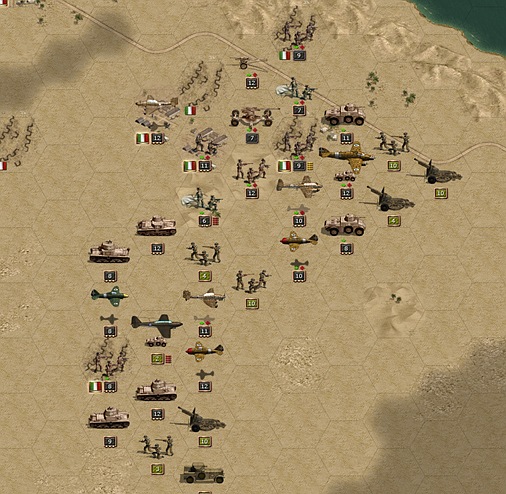

    asuser hat geschrieben:I played the first two scenarios and in the second, there is a light misunderstanding...
    Nice map and the british troops comes slowly ... but the following massages (round 8/12) are strange:
    I played the Italians and I should destroy my own support camps?
    After finish the 2. scenario comes this:
    I hold all of my strong points (round 12/12), but couldn't reach a decisive victory - thats why the military leaders are not satisfied...?
    I assume that the pop-up in German is during the Fort Capuzzo mission? If that is the case, then a mistake has been made in German translations. This scenario mentions nothing about depots.
    I did change the pop-up messages somewhat, make them more understandable. Commando Supremo cannot reward a decisive victory when you disobey orders.

    von Kemmelberg hat geschrieben:I assume that the pop-up in German is during the Fort Capuzzo mission? If that is the case, then a mistake has been made in German translations. This scenario mentions nothing about depots.
    Yes, it was Fort Capuzzo. If I hold all of my strongpoints, then I have a decisive victory! There is something to change...
